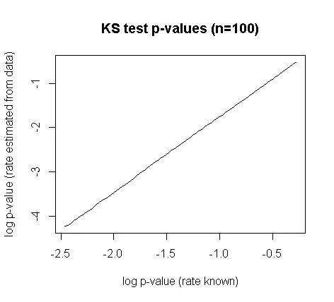

You can compare the observed value of the KS test statistic calculated from the data to the tabulated critical values given in the reference. Or simulate the distribution of the statistic yourself as @Glen_b & @soakley have suggested. Note that Lilliefors points out its distribution doesn't depend on the true values of the parameters—generally true for scale & location parameters—, so for a given sample size you can do this once simulating from the standard exponential distribution, & keep the results for future reference; you don't need to repeat the simulation for each new data-set of the same sample size. And there's therefore no approximation involved (except that coming from simulation error). The difference made to the distribution of the KS statistic $D$ by estimating rather than pre-specifying the parameters is not trivial: Kernel-smoothed density estimate of D's distribution under null (n=100)
Lilliefors does give some asymptotic results (worked out rather crudely, but good enough for government work). Stephens has tabulated quantiles for the modified statistic
$$T(n) = \left(D - \frac{0.2}{n}\right)\left(\sqrt{n} + 0.26 + \frac{0.5}{\sqrt{n}}\right)$$
where $D$ is the KS test statistic & $n$ the sample size. According to Durbin (1975), "Kolmogorov–Smirnov tests when parameters are estimated with applications to tests of exponentiality and tests on spacings", Biometrika, 62, 1, these are very close to the exact values for larger sample sizes. They can be found in Pearson & Hartley (1972), Biometrika Tables for Statisticians, CUP, or in Stephens (1974), "EDF Statistics for goodness of fit and some comparisons", JASA, 69, 347. I'm not aware of any published correction to the p-value of the ordinary KS test to approximate that of the Lilliefors test; a power-law relationship seems like it might be useful: KS test p-values (n-100)
