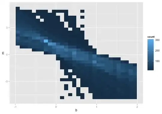

A Hough Transformation should help. It's mainly used for detecting lines is images, but (x,y) pairs can be considered a sparse representation of a bitmap image.
The idea is for each (x,y) point in the input, compute a list of (slope, intercept) pairs which represent "all" lines that pass through that point. "all" is constrained to some ranges of slope and intercept and granularity limit. If you look at or analyze the resulting collection of (slope, intercept) pairs, you'll see a cluster for each line in the input.
Often the (slope, intercept) pairs are represented as an image or scatter plot with transparency, so that clusters or co-incident values appear as dark spots (or bright spots depending on you color settings).
(Addition after comment from @whuber: There are other possible transformations besides slope/intercept. Angle/intercept puts the first coordinate in a nicer range, and angle/distance-to-origin avoids the intercept bounds issue for near-vertical lines.)

This generates the following plot:
In the plot, the actual slope and intercept of the true line is circled. Alternatively, use ggplot2 and stat_bin2d showing count per bin.
We'll do something similar to ggplot above to find a "best guess" estimate:
# Make a best guess. Bin the data according to a fixed grid and count the number of slope-intercept pairs in each bin
slope_intercepts = all_slopes_and_intercepts
bin_width.slope=0.05
bin_width.intercept=0.05
slope_intercepts$slope.cut <- cut(slope_intercepts$slope,seq(-5,5,by=bin_width.slope))
slope_intercepts$intercept.cut <- cut(slope_intercepts$intercept,seq(-5,5,by=bin_width.intercept))
accumulator <- aggregate(slope ~ slope.cut + intercept.cut, data=slope_intercepts, length)
head(accumulator[order(-accumulator$slope),]) # the best guesses
(best.grid_cell <- accumulator[which.max(accumulator$slope),c('slope.cut','intercept.cut')]) # the best guess
# as the best guess take the mean of slope and intercept in the best grid cell
best.slope_intercepts <- slope_intercepts[slope_intercepts$slope.cut == best.grid_cell$slope.cut & slope_intercepts$intercept.cut == best.grid_cell$intercept.cut,]
(best.guess <- colMeans(best.slope_intercepts[,1:2],na.rm = TRUE))
points(best.guess['intercept'], best.guess['slope'], col='blue', cex = 4)
This could be improved in all sorts of ways, e.g. by running a kernel density estimation on the data and picking the likelihood maximum.

    The Hough transform will work better and exhibit less bias when you measure slope as an angle rather than as a slope (which is the tangent of the angle). The plot of an individual point in the Hough transform should be sinusoidal, as illustrated here, rather than linear. – whuber Aug 18 '14 at 14:32
