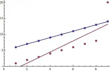

If you only want to show $r^2_{xy}$ must be close to 1, and compute a lower bound for it, it's straightforward, because that means for given $U$ and $n$ you only need to maximize the variance of the residuals. This can be done in exactly four symmetric ways. The two extremes (lowest and highest possible correlations) are illustrated for $U=20, n=9$.
Extreme correlation plots for U=20, n=9
For large values of $U$ and appropriate values of $n$, $r^2_{xy}$ can actually get close to 0. For example, with $n=100$ and very large values of $U \gg n$, $r^2_{xy} \sim 0.03$ in the worst case.
