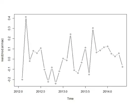

Per request, here are the residuals from the two parametrizations.
First from the fit:
fit <- arimax(log(cds), order=c(1, 0, 0),
              xtransf=
              data.frame(Oct13a=1 * (seq_along(cds) == 22),
                         Oct13b=1 * (seq_along(cds) == 22)),
              transfer=list(c(0, 0), c(1, 0)))
plot(resid(fit), type="b")
Then, from this fit
mod.arimax <- arimax(log(cds), order=c(1, 0, 0),
                     seasonal=list(order=c(0, 0, 0), frequency=12),
                     include.mean=TRUE,
                     xtransf=data.frame(Oct13=1 * (seq(cds) == 22)),
                     transfer=list(c(1, 1)))
mod.arimax
plot(resid(mod.arimax), type="b")

  • Is this output saying that the only "intervention" in the Oct 13 to current time period is a single pulse for Oct 13 and then the series returns to its normal mean level? – B_Miner Jul 24 '14 at 00:21
  • I added the residuals from both parametrizations. To my eye, it seems like the first one I listed (the one originally fit by javlacalle) is better. Agree? – B_Miner Jul 24 '14 at 00:46
