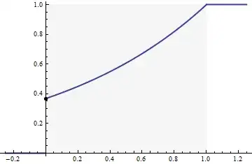

The calculations in the question look correct, but care is needed because the distribution of $V_\mu$ is not continuous. (I will use $\mu$ instead of $m$ throughout.)
From first definitions we may find the distribution function (CDF) of $V_\mu$ is
$$F_\mu(x) = \Pr(V_\mu) \le x) = \sum_{n=0}^\infty x^n \Pr(N_\mu = n) = e^{\mu(x-1)}$$
provided $0 \le x \le 1$. For $x \gt 1$, $F_\mu(x) = 1$ of course. But for $x \lt 0$, necessarily $F_\mu(x) = 0$. Here is its graph when $\mu=1$ showing the jump at $x=0$:
Figure
The moment generating function, $\phi_\mu(t) = \mathbb{E}(\exp(t V_\mu))$, must be computed with similar care near zero. It can be obtained as a Lebesgue-Stieltjes integral,
$$\phi_\mu(t) = \int_\mathbb{R} e^{t x} dF_{\mu}(x)$$
via integration by parts as
$$\phi_\mu(t) = e^{t x} F_\mu(x) \vert_{-\infty}^1 - \int_0^1 t e^{t x} e^{\mu(x-1)}dx = e^t - t\frac{e^t - e^{-\mu}}{t+\mu}.$$
As a check, its McLaurin series begins
$$\phi_\mu(t) = 1 + \left(\frac{\mu-1+e^{-\mu}}{\mu}\right) t + \left(\frac{\mu^2 - 2\mu + 2 - 2e^{-\mu}}{\mu^2}\right)t^2/2 + \cdots$$
The constant term of $1$ shows the total probability mass is $1$. The next two terms will be useful in addressing the rest of the questions.
