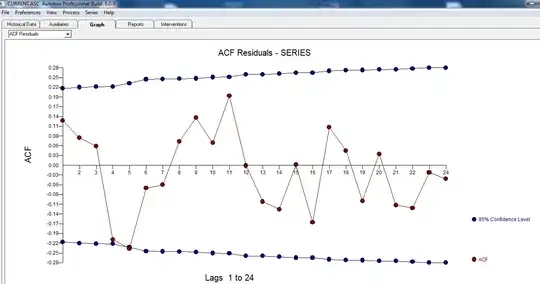

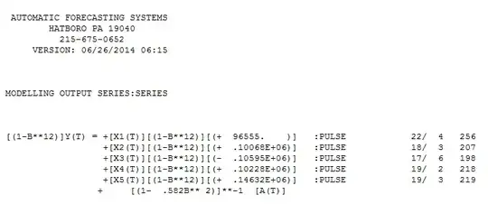

A reasonable model was identified using http://www.autobox.com/cms/ which is a piece of software that incorporates some of my aforementioned ideas as I helped develop it. enter image description here The Chow Test for parameter constancy suggested that the data be segmented and that the last 94 observations be used as model parameters had changed over time.enter image description here .These last 94 values yielded an equationenter image description here with all coefficients being significant.enter image description here . The plot of the residuals suggests a reasonable scatter enter image description here with the following ACF suggesting randomness enter image description here . THe Actual and Cleansed graph is illuminating as it shows the subtle BUT significant outliers.enter image description here . Finally a plot of actual,fit and forecast summarizes our work ALL WITHOUT TAKING LOGARITHMS enter image description here. It is well known but often forgotten that power transforms are like drugs .... unwarranted usage can harm you. Finally notice that the model has an AR(2) BUT not an AR(1) structure.
