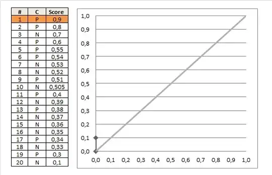

Drawing ROC curve
Given a data set and a ranking classifier:
  • order the test examples by the score from the highest to the lowest
  • start in $(0, 0)$
  • for each example $x$ in the sorted order
    • if $x$ is positive, move $1/\text{pos}$ up
    • if $x$ is negative, move $1/\text{neg}$ right
where $\text{pos}$ and $\text{neg}$ are the fractions of positive and negative examples respectively.
This nice gif-animated picture should illustrate this process clearer
building the curve
On this graph, the $y$-axis is true positive rate, and the $x$-axis is false positive rate. Note the diagonal line - this is the baseline, that can be obtained with a random classifier. The further our ROC curve is above the line, the better.
