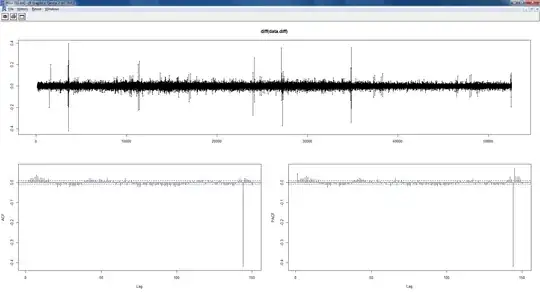

data.ts = ts(log(data) data.diff = diff(data.ts, 144) plot.ts(data.diff)
Datadiff
Which seems somehow stationary to me. I then proceed to look at the acf/pacf, and had to differentiate once more because it wasn't stationary in fact :
tsdisplay(data.diff, lag.max=150) tsdisplay(diff(data.diff), lag.max=150)
Tsdisplay Tsdisplaydiff
And I really don't know how to handle these results, so I hoped I could find some help here, because I came across the website a lot during my researchs.
