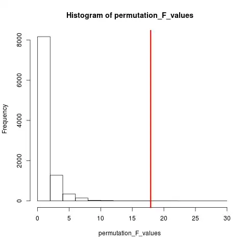

Randomization/permutation tests
Be warned, terminology is not agreed upon. See Difference between Randomization test and Permutation test.
The null hypothesis would be that there is no difference between the populations of groups A, B and C, so it shouldn't matter if we randomly exchange the labels of the 15 values of Xvar. If the originally observed F value (or another statistic) doesn't agree with those obtained after randomly exchanging labels, then it probably did matter, and the null hypothesis can be rejected.
observed_F_value <- anova(lm(Yvar ~ Xvar))$"F value"[1]
n <- 10000
permutation_F_values <- numeric(length=n)
for(i in 1:n){
   # note: the sample function without extra parameters defaults to a permutation
   temp_fit <- anova(lm(Yvar ~ sample(Xvar)))
   permutation_F_values[i] <- temp_fit$"F value"[1]
hist(permutation_F_values, xlim=range(c(observed_F_value, permutation_F_values)))
abline(v=observed_F_value, lwd=3, col="red")
cat("P value: ", sum(permutation_F_values >= observed_F_value), "/", n, "\n", sep="")
histogram
Be careful with the way you reassign the labels in the case of complex designs though. Also note that in the case of unequal variances, the null hypothesis of exchangeability is not true in the first place, so this permutation test wouldn't be correct.
Here we did not explicitly go through all possible permutations of the labels, this is a Monte Carlo estimate of the P-value. With small datasets you can go through all possible permutations, but the R-code above is a bit easier to understand.
