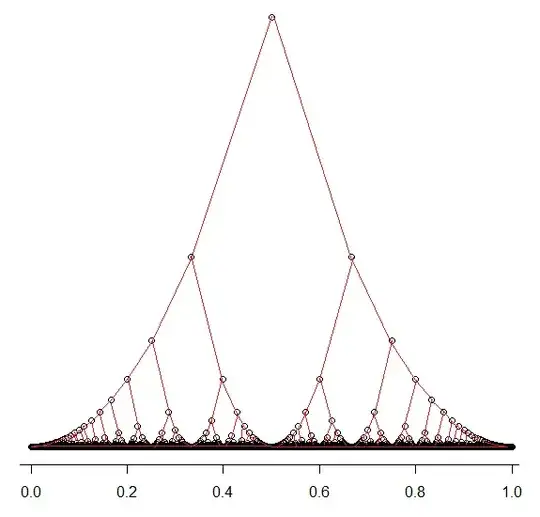

Here is another example, taken from https://math.stackexchange.com/questions/189813/is-this-graph-based-on-rationals-familiar
$$\Pr\left(X = \frac{a}{b}\right) = \frac{\zeta(k)}{\zeta(k-1) - \zeta(k) } \left(\frac{1}{b}\right)^k$$ when $0 \lt a \lt b$ with $a$ and $b$ coprime, using some $k \gt 2$ and where $\zeta(k)$ is the Riemann zeta function.
The probability mass function looks roughly like this when $k = 2+\delta$ for small positive $\delta$ (without the decorative red lines)
Henry
  • 39,459
  • Is $a$ indeed absent from the PMF? – Alecos Papadopoulos Oct 04 '23 at 21:46
  • @AlecosPapadopoulos - yes, and that gives the symmetric distribution. It also means that in the fourth row of points down there are four points with equal probabilities corresponding to $\left(\frac15, \frac25,\frac35,\frac45\right)$ – Henry Oct 04 '23 at 21:50
