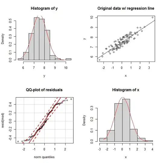

Of course, those do seem like rather strange possibilities, so what if the marginal distributions appear normal and the joint distribution also appears bivariate normal, does this necessitate that the residuals are normally distributed as well? As I tried to show in my answer I linked to above, if the residuals are normally distributed, the normality of $Y$ depends on the distribution of $X$. However it is not true that the normality of the residuals is driven by the normality of the marginals. Consider this simple example (coded with R):

In the plots, we see that both marginals appear reasonably normal, and the joint distribution looks reasonably bivariate normal. Nonetheless, the uniformity of the residuals shows up in their qq-plot; both tails drop off too quickly relative to a normal distribution (as indeed they must).
