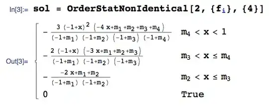

where OrderStatNonIdentical is a function from the mathStatica package for Mathematica, and where $n$ and $k$ are integers. For the OP's question, in a sample of size $n = 4$, the pdf of the 2nd smallest order statistic is given immediately by:

  • Similarly, the pdf of the 3rd order statistic is:
... and here is a plot of same:

It appears possible to attain general symbolic solutions by induction, at least for the 1st and 2nd order statistics. In particular:
  • the pdf of the 1st order statistic, irrespective of the size of $n$, has form:
$$ \begin{cases} \frac{n(1-x)^{n-1}}{\prod_{i=1}^n (1-m_i)} & m_n < x < 1 \\ \quad \quad \dots & \quad \quad \dots \\ \frac{3(1-x)^2}{(1-m_1)(1-m_2)(1-m_3)} & m_3 < x \leq m_4 \\ \frac{2(1-x)}{(1-m_1)(1-m_2)} & m_2 < x \leq m_3 \\ \frac{1}{1-m_1} & m_1 < x \leq m_2 \\ 0 & \text{otherwise} \end{cases}$$
  • the pdf of the 2nd order statistic has form:
$$ \begin{cases} \frac{(n-1)(1-x)^{n-2}}{\prod_{i=1}^n (1-m_i)}(n x-\sum_{i=1}^n m_i) & m_n < x < 1 \\ \quad \quad \dots & \quad \quad \dots \\ \frac{2(1-x)^1}{(1-m_1)(1-m_2)(1-m_3)} (3x-m_1-m_2-m_3) & m_3 < x \leq m_4 \\ \frac{1(1-x)^0}{(1-m_1)(1-m_2)} (2x-m_1-m_2) & m_2 < x \leq m_3 \\ 0 & \text{otherwise} \end{cases}$$
