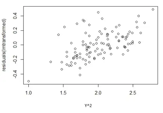

Also: what does a plot of residuals vs the Y variable show and how should it look? Mine looks like this, does that seem ok?
residuals vs y

  • why does your x-axis have the label Y^2? That would imply you're either squaring $y$ or plotting $\hat{y}_2$ -- and in either case that's not sounding like what your text says it is. Is your y-variable really called Y^2?? – Glen_b May 28 '14 at 02:30
  • Oh my model was lm( yVar^2 ~ xVar+xVar+xVar ), i transformed it by squaring because otherwise the residuals weren't normally distributed. The Y^2 label is a bit confusing though as it seems like the Y should be the transformed Y already. – Stefan May 28 '14 at 08:43

4 . scatter plot: plot residuals against Y and Yˆ
Should the datapoints be evenly scattered around the horizontal 0 line?
No. Residuals are correlated with $Y$. It should look like it's increasing. I normally advise against using that plot unless you understand what it is showing you (I am quite aware of the potential pitfalls, but I usually avoid it myself unless there's a particular reason to view it).
See the discussion here for an explanation of why they're correlated.
For residuals vs $\hat y$, comments are similar to the comments above in respect of individual $x$-variables - you may get pattern in $\hat y$ because of pattern in the $x$-variables, but it's pattern in the vertical (y) direction that's at issue - residuals having mean not very near zero over some x's - that you're looking for. Again, spread should be roughly constant.

  • So I guess that my residuals vs Y plot then doesn't seem very unreasonable for a linear model then? – Stefan May 28 '14 at 08:50
    I can't see anything that would suggest there's a problem, but the residuals vs y-hat would be a better place to look. – Glen_b May 28 '14 at 10:31
