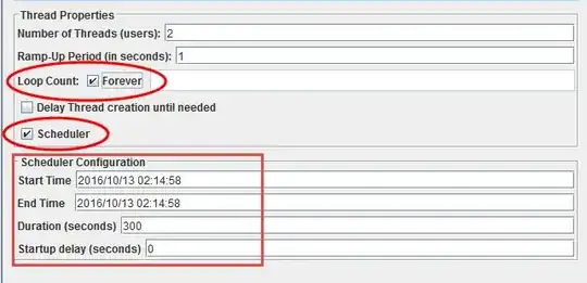

You can do this by using JMeter Scheduler: In Thread Group tick the Scheduler and set the value as below:
Start Time and End Time: No need to input. keep them as they are, because they have no significant after entering Duration and Startup delay value. Delay overrides Start Time, and Duration overrides End Time.
For example, if you want to run the test for 2 min. Input the value as below:
Duration (seconds): 120
Startup delay (seconds): 0
Now it's the time to run the test: Run -> Start

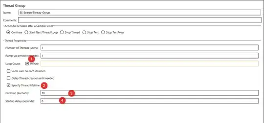

Latest Answer,
Just follow the above mentioned steps,
  1. Select the Thread Group.
  2. Check the option for the infinite loop.
  3. Check the option for the Specify Thread lifetime.
  4. Enter the duration in seconds for the thread group to run.
Let me know if you face any problem in this. :)

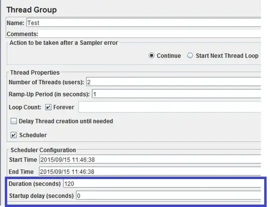

I just applied below configuration and it worked for me.
