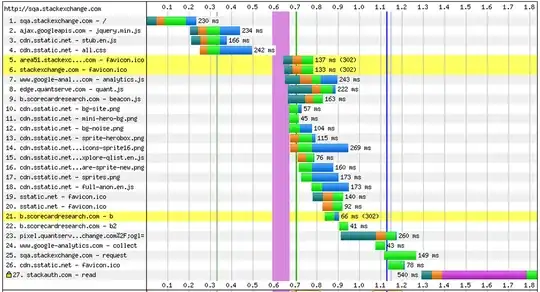

  • You can also use a page speed test service, or plug-in. Yslow is a popular plug-in for firefox. Webpagetest.org is a free service to give you a "waterfall" diagram of the page load. Both of these give a score (A-F) on various attributes. Here is the webpagetest result for sqa.stackexchange.com: http://www.webpagetest.org/result/140411_5N_XZB/ Screenshot of webpagetest.org report for sqa.stackexchange.com
