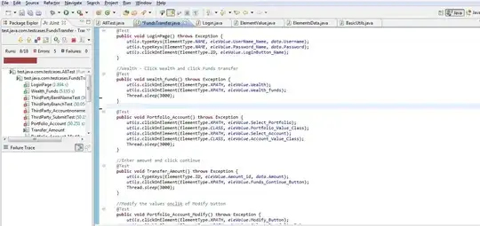

Find the attached screen shot for reference(Scripts with result)
I executed some selenium scripts, but they are not running properly. Execution is taking the scripts randomly and start execution. I want to execute the scripts as per script order. Please tell me a solution for this.
For example the scripts' order is:
  1. Loginpage (1)
  2. Dashboard (2)
  3. firstlink (3)
  4. secondlink (4)
  5. thirdlink (5)
Execution order:
  1. firstlink (3)
  2. Dashboard (2)
  3. secondlink (4)
  4. loginpage (1)
  5. thirdlink (5)
How to execute these scripts in the proper order?

    Scripts are not able to run randomly just only in that case when you call them randomly. Computers do that what you tell them. Did you write the code? Do you know who did it? Did you ask him/her what is the expected behaviour or execution order? On the other hand, please provide more information because not possible to answer your question. Or the answer will be yes, or 42. ;) – AndrasCsanyi Jan 28 '14 at 07:37
Two parts to this answer: First, to answer the question, there are many test runners. Some of them by default will run in a particular order, it may be the order they appear in code, or alphabetically, or some other order. There is often a way to tell the test runner to execute them in a particular order by providing some additional command line parameters, or altering the config. From your screenshot you're using junit, junit actually does not have a way to force the order of execution, see this for details: https://stackoverflow.com/questions/3693626/how-to-run-test-methods-in-specific-order-in-junit4
The second part is not directly answering the question, but is important and is also discussed in the linked answer from stackoverflow. You should avoid having tests that need to be run in a specific order. What if you want to execute only the last test, or debug the last test? Do you have to wait for all of the other tests to execute? What if one of the tests early in the chain fails, likely all of the rest of the tests will fail as well. What happens when you get a large suite of tests and you want to execute them in parallel? It is typically a best practice to have individual tests self contained and not relying on other other tests for the reasons outlined above.

There is no default provisioning in JUnit to do this the way you want. By using MethodSorters.NAME_ASCENDING you can ensure order by naming tests in alphabetical order as showed in other answer. Alternatively, you can create your own OrderedRunner and an annotation to fix this type of ordering.

  • Thanks for your answer. I tried this annotations in my script. But still i am facing the same problem. can you please tell me, where i need to add this annotation "@RunWith(OrderedRunner.class)". – sathi Feb 04 '14 at 10:20
  • It is not just annotation, you have to create the annotation as well. You have to put the annotation above your test class as shown in the code. Previously the annotation line is not highlighted along with the code. Now I updated it to reflect that. – Buddha Feb 04 '14 at 12:30
There is a new method you could use which is the @FixMethodOrder(MethodSorters.NAME_ASCENDING) and place this outside of your class, e.g.
public class HowDoIRunMyTestsInOrderIWant {
public static ChromeDriver chrome;
@BeforeClass
public static void launchBrowser(){
some code goes in here
@Test
public void aLogIn(){
your code = chrome.findElement.blahblah
@Test
public void bAnotherTest(){
some code in here
So by naming them in an alphabetical order they will run as you wish.
Hope it helps you.
Django_Tester
  • 173
  • Thanks for your reply. I dont know how to use this annotation. I created annotation class. Inside that method what i need to mention.. Can you please explain me briefly. – sathi Feb 04 '14 at 10:27
  • So for each @Test method name, you will specify the order to follow in alphabetical ordering. So.. Test 1 public void aThisIsMyFirstTest() Test 2 public void bThisIsMySecondTest() Test 3 public void cThisIsMyThirdTest() Test 4 public void dThisIsMyFourthTest() Test 5 public void dThisIsMyFifthTest() and so on. Just like I said in my answer. Does that make sense? – Django_Tester Feb 04 '14 at 12:21
  • yes this is fine. I created method like you mentioned above. But i created annotation method as "public @interface FixMethodOrder {
    }" - inside this method, instead of dash line, what i need to write. Also i added this annotation(@FixMethodOrder(MethodSorters.NAME_ASCENDING)) outside of my class. But i am getting error message. Can you tell me the solution..
    – sathi Feb 05 '14 at 04:37
  • @sathi You only need to add the FixMethodOrder once, and declare it outside of your class. You do not need to add it again when annotating methods. This is probably why you are receiving an error. Try removing it from the method I let me know if you are still receiving an error. If so, please post the stack trace. – Django_Tester Feb 07 '14 at 09:37
