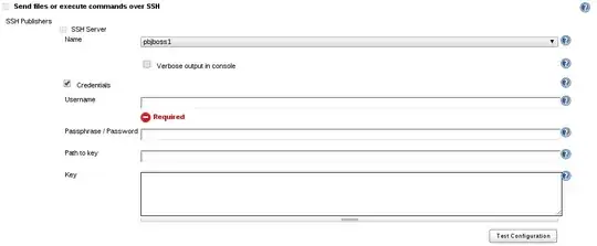

Another option would be to use the Publish Over SSH Plugin which can let you specify credentials to use during the connection - This would let you issue credentials to each user, and then have the server decide whether to allow the connection or not.
Toby Jackson
  • 779
  • Thank you. Do I need to use "ssh-keygen" to generate ssh private key before using this plugin? – B Faley Jan 13 '14 at 08:34
  • Not necessarily, it can either be setup to have a users username and password, or a keyfile with passphrase. The various input fields just let you setup the credentials in a few ways eg; Username+Password, Username + Path to key on jenkins master, Username + path + passphrase etc.
    If you'd like the most secure method, use the username, a path to key on the jenkins master and a passphrase. It prevents the private key being exposed through the config ui (though its probably still accessible in other ways)
