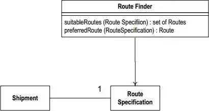

When I was writing my question (I'm the OP) I did not know Eric Evans and Martin Fowler already defined it. It originally addressed the problem of validation whether a given candidate object matches certain criteria (a specification), by defining Speficiation interface with a isSatisfiedBy(Candidate c) boolean method. Specification was said to be also a solution to the problem described in the OP question: to generate test data matching certain specification. The authors generalized it to:
You need to describe what an object might do, without explaining the details of how the object does it, but in such a way that a candidate might be built to fulfill the requirement.
I think their example of this problem, even if not discussed in testing context, is more illustrative than mine (in the original question):
The customer provides a route specification for the shipment. The shipping company will use the specification as a constraint in coming up with a route.
Unfortunately, you won't find much details how to implement that in their article. I would start from a generic interface CandidateGenerator with the generateCandidateMatching(Specification s): Candidate method. The interface can be implemented using one of the following patterns:
  • Factory pattern, that constructs a candidate matching the specification, as user246 suggested.
  • Finder "pattern", that searches for a candidate (e.g., in a database), e.g., RouteFinder would query route database for a route, by translating a specification into one or more database queries:
  • Factory with Finders, a combination of above: search database for available itineraries and then construct a new route with those itineraries.
Design guidelines
  • Having specification implemented you can always verify whether CandidateFinder or CandidateFactory returns correct candidate by passing it to the isSatisfiedBy() method.
  • Specification can be a composition of smaller specifications (as Evans and Fowler envisioned), so generating a final candidate can be done by generating candidates for smaller specification and then combining them together.
  • Naive implementation of a Finder would be to iterate over all candidates and evaluate specification over each of them. It is naive, because this approach might be inefficient and not always possible (you might not have access to all candidates); that's why DBMS build query plan for a query.
  • Specification can be defined with the Builder pattern, as Dale Emery proposed.
