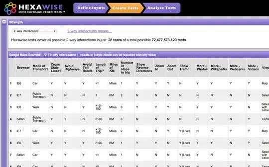

I'd highly suggest looking at the Google Maps test plan example found here: https://app.hexawise.com/share/94JBFALL and then taking a crack at designing a similar set of draft tests for your SUT.
The draft tests you'd create would be good but imperfect. They'd cover a lot in a relatively few tests but you would be well advised to add other types of tests rather than rely on any one particular testing strategy.
Unfortunately, a login to our test design tool is required to look at that Google Maps example in detail. Accordingly, I've created a free account for you at david.keaveny@stackexchange.com (I know it's not your real address, but I had to use something). I've sent you the password to your account to you via LinkedIn.
To recreate a similar - very early draft - plan for yourself, I'd suggest going through the following steps to put together a relatively small number of highly informative end-to-end-ish tests:
  1. Ask WHAT can change as users go through the system? Think about configuration settings, user actions, data formats, data ranges, etc. even throw in more "creative" ideas like user personas. Let your creativity and common sense guide you. Enter those in as Parameters.
  2. Ask HOW those parameters can change? (for the Parameter "Browser" enter IE7, IE8, FF, etc.) Put those in as Values under each parameter (entering constraints as required)
  3. Ask does that variation MATTER? (e.g., use Equivalence Classes and be biased towards fewer Values vs. more - at least for your early draft tests)
  4. Ask what SPECIAL paths thorough the system do you want to be sure to include? (Most common happy path, paths to trigger certain business rules, etc.)
Click the Create Tests button and you'll instantly get a very nice DRAFT starter set of highly varied tests. If they look like they're relatively interesting and don't miss hugely important things, start informally executing them and you'll be sure to learn some more things as you do about the system's weak points that would result in you going back to those DRAFT tests and iterating them to make them stronger and cover more.
This is unfortunately a rather "abstracted" example, devoid of a practical example in this text. A couple examples that might make this approach a little more "real" can be found at http://hexawise.com/case-studies/insurance and http://hexawise.com/case-studies/mortgage If it has captured your interest and you'd like to talk more, I'd be happy to explain how you could try to apply this approach to your specific SUT if you'd be interested.

  • Many thanks for such a detailed answer; I've had a look at Hexawise and it looks very useful. I plugged in some initial input values - my 46 fields yielded 2.1E18 combinations, although Hexawise boiled that down to 88 tests! Digging through the source code, it's looking like a lot of the configuration options are orthogonal, so I can probably reduce that still further. – David Keaveny Dec 18 '12 at 23:01
