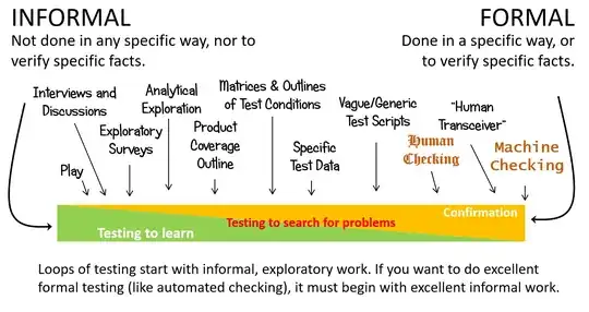

Is this the best to plan your testing, especially at this early stage when you are focused on learning about the application? Of course, if you are going to automate some flow, you will have a test case, but written in a programming language - does it bring value to have ambiguous non-executable scripts (English-written test cases) at this point?
If you are looking for traceability, I would suggest reading the blog post Breaking the Test Case Addiction, by Michael Bolton.
Alternatively, you can have test charters and product coverage outlines.

Just a few ideas to what you said:
I was thinking of going through the past bugs/tickets/stories developed and prepare test cases based on that.
Going through some of these sources of information could be useful, but it's only something you should do in addition to actually interacting with the application. You need to learn the application, and that's best done by actually interacting with the product, not by reading a secondary source of information.
Also to start preparing test cases for regression tests for key functionalities
Why not, but you need to know what the key parts of the app are. That will take a bit to learn.
I will consider automating the regression suite with Selenium most likely.
Why jump to conclusion about a technology so early when you don't even know the app? Your tools should be chosen based on what helps you best in a given context, but you don't really know the context, not the app, yet.
