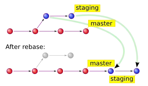

- Features branch testing would yield better information the closer your branch is to the state the change history will be after merge.
If non fast-forward merging and long-lived branches are the most common cause in your repository, the info you uncovered by testing is more likely to not be valid after merge.
To mitigate this, constant rebasing and constant merge against master.
