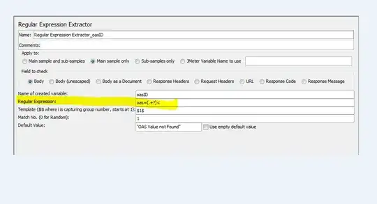

enter image description here I need to pass the payment id from request to subsequent request.
Tried with that...But the default value only passing as shown in the image...enter image description here
enter image description here.imgur.com/HMeXa.png

You can use the Regular Expression Extractor.
You can simply select URL as Field to check and capture the end of the URL and place in a variable, which can be used afterwards.

  • Changes made as shown in the image...but it only passing the value which i have configured in subsequent request – syed Jul 26 '19 at 06:05

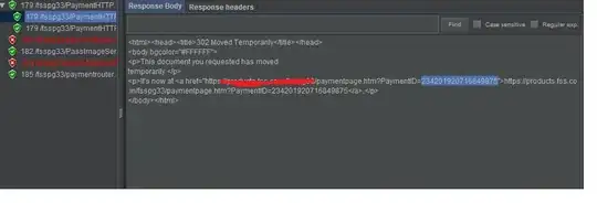

Here i have attached my response bodyenter image description here
syed
  • @ImpactQA here i have attached my response body. in that response body i need to capture the payment id which is dynamic for every request and need to send in subsequent request. – syed Jul 26 '19 at 09:38
  1. Change "Field to check" to Body
  2. Change Regular Expression to be:
    PaymentID=(\d+)"
