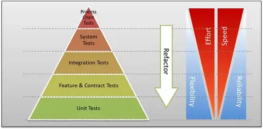

Indeed your observation is correct.
Every level of checking aims to give you confidence on what is being checked: Code unit, service contracts, systems, etc....
Two generic observations that we can have with the Test Pyramid is:
  • Precision increases when you "go down" the Pyramid: If a unit test fails, you probably know exactly where in the code you had a problem - but you have no idea how does this affect your system.
  • Reliability increases when you "go up" the Pyramid: If an end-to-end test fails, you surely have a bug on the system - but you don't know where.
Let's say you have a Linked List structure that has a bug when dealing with a very large number of elements. If you add a unit check, you will find this problem right away. However, if the UI never allows your user to reach such a situation, you may never have an end-to-end check that will exercise it.
On the other hand, if you add an end-to-end check, you are indirectly exercising a manifold of possible unit checks. If you find a problem with an end-to-end check, you will have to chase down the multiple of problems your code may have - to "mirror" it with unit checks, you would have to create many unit checks.
I would say that the importance of a solid unit checking base increases when your time-to-market decreases. If you must ship twice a day, you cannot rely on adding new end-to-end checks every day - you have to try to cover yourself with unit-level checks and fix the gaps left ASAP.
João Farias
