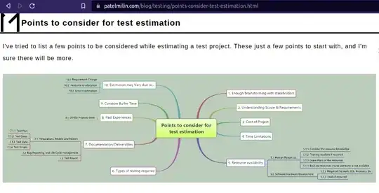

Along with the answers mentioned, this article is also helpful in estimating a testing project.
