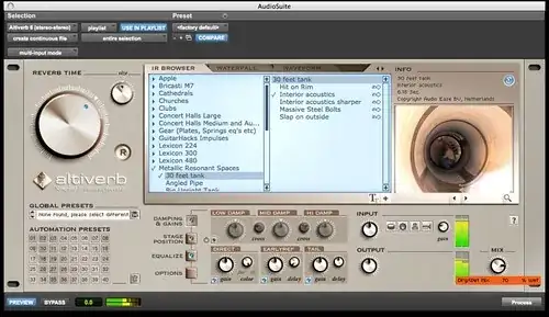

If its for film I personally would likely do more than just stereo-ize it, depending on the context/location/point of view that you are hearing it from - I'd use Altiverb with real & non-real IRs to spread the drone to L/R and into surrounds.... But it totally depends where you want the sound to appear to be coming from & how present you want the pulse to be... I'd probably use LowEnder to reinforce the pulse of it with low frequencies & LFE....

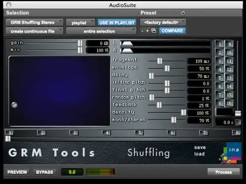

I've tried some of the aforementioned processing and uploaded it, file names included the user who suggested the technique. I'll try to process a few more tomorrow. I've also made the original tracks downloadable (at least for a few weeks or so) in case some of you want to mess around with "stereoizing" 'em. [soundcloud]adamaxbey/engine-2-shaun-farley-aux-10db[/soundcloud] [soundcloud]adamaxbey/engine-2-chris-fonte[/soundcloud] [soundcloud]adamaxbey/engine-2-filipe[/soundcloud] [soundcloud]adamaxbey/engine-2-shaun-farley[/soundcloud] [soundcloud]adamaxbey/engine-2-tim70-wet[/soundcloud]
alt text
[soundcloud]adamaxbey/engine-2-mattlange-grmshuffle[/soundcloud]
alt text
[soundcloud]adamaxbey/engine-2-mattlange-grmfreeze[/soundcloud]

Also, at the expense of being a little more forceful with the sound, using a granular process with a fair amount of pan jitter and a fast grain rate can do wonderful things to a mono image. slap a reverb on afterwards to smooth it out, sounds instantly ominous.
