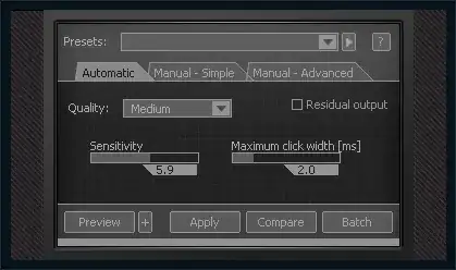

I'm all about iZotope RX. It's such a lifesaver for me. I do everything from lowering the noise floor on recordings, removing clicks and clipping, to removing a cough from a live music performance (I actually got that one to work perfectly!! I'll have to see if I can find the original and final to let you guys A/B the two).
iZotope RX
(source: izotope.com)
If it's something really tiny and don't want to spend time in RX (it can be very time consuming for more complex fixes), I'll go with the old pencil tool trick.

  • Thanks a bunch! So Izotope RX will take clicks out of a voice without artifacts? – Utopia May 06 '10 at 16:27

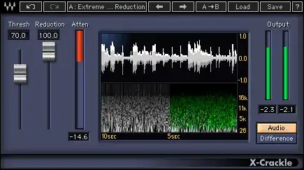

Try these:
Waves X-Click and X-Crackle
Izotope Rx
Note: Izotope has a full-featured demo that you can audition before you buy to see if it will work for your needs.

Waves X-Crackle
(source: waves.com)

  • I have X-Click but can't get it to not artifact a voice. Have you had any luck using it on a voice to remove mouth noise? – Utopia May 14 '10 at 01:14
