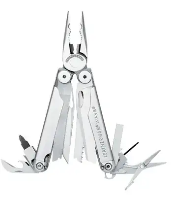

Multitool (mine's a Leatherman Wave)
alt text
(source: leathermans.co.uk)
