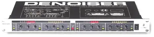

A few years back, I was adviced to check out the Behringer denoising hardware uni.
alt text
(source: doctorvmusic.com)
I was a bit sceptical to say the least, but figured that it wouldnt hurt to try it out, when I found a used model for about $50. I was blown away by the fact that it works very very well. I know that the name makes alot of peoples skin crawl, but this thing does what its meant to do, and does it really well! I have removed noise (hum, clicks, buzz, backgrounds, reverb) with this thing with great results, and without getting those artifacts that plugs often bring.
Mikkel
Glorfindel
  • 593
Mikkel Nielsen
  • 796
  • @Mikkel Nielsen I'm tempted to buy one for so cheap. Ebay has a ton right now. Is it good for mono voice recordings in noisy environments? Tape hiss? – Utopia Jul 14 '10 at 18:04
  • I think you can get great results with this, in almost any case. If you want to, you can send me a noisy file and I can send it through the unit, and send it back to you. How does that sound? Send it at gimaudio[at]gmail.com – Mikkel Nielsen Jul 15 '10 at 07:34
