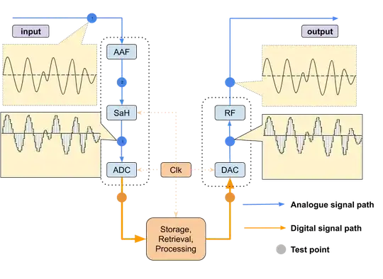

enter image description hereThis diagram shows an example signal flow for a digital signal processor. Each side of the signal at a test point, should have roughly identical signals.
At the input stage is a full-range, full spectrum signal.
It should be said at the outset, that PCM digital audio does not reproduce the entire signal bandwidth. The amount of bandwidth that can be encoded is equivalent to just under half the sampling frequency (fs). Any signal that arrives at the input stage that contains frequencies that are greater than half the sampling frequency will be encoded as ‘alias’ frequencies that ‘fold’ around the “Nyquist” frequency (fs/2). This results in clearly audible artefacts in the recording, so a filter stage must be included that significantly attenuates any frequencies that are above the Nyquist frequency (fs/2). This filter is called an “Anti-Aliasing Filter” and is shown in the diagram as the [AAF] block.
The output of the [AAF] block (anti-aliasing filter) is going to be the basis upon which any audio can be decoded and the output of the processor will never be any better than what can be seen at the output of the anti-aliasing filter.
It is generally accepted practice that, in a sampling based system such as this, that the sampling frequency chosen will always be at least twice the value of the highest frequency that you need to reproduce. For instance, a system that samples audio at 48,000 samples per second can accurately reproduce frequencies below 24,000 Hz. A sampling frequency of 44,100 samples per second can accurately reproduce frequencies below 22,050 Hz. The limit of human hearing is between 16-18 kHz.
(It should be noted at this point that improvements in converter design and implementation usually employ "oversampling" so that the nyquist frequency is well north of any audible signal preventing any potential aliasing artifacts and also permitting much more subtle aliasing filters to be employed.)
Signal Sample and Hold [SaH]

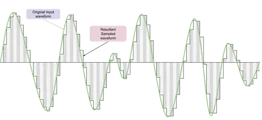

enter image description here The first ‘stage’ or ‘block’ after the anti-aliasing filter is a ‘sample and hold’ stage. This is denoted on the block diagram as the [SaH] block.
The ‘sample and hold’ stage is driven by a clock pulse which will present itself to the sampling stage as a square wave with equal periods driven at the desired 'sampling frequency' (fs). Each time that the clock pulse goes from a low value to a high value, the circuit ‘samples’ the analogue signal contained at the input, and retains that signal value for the duration of the sampling clock period. When the next clock pulse comes along (low to high) a new ‘sample’ is taken.
The accuracy of the sampling clock is critical to the accuracy of the sampling process and eventual reproduction. Errors in the sampling clock result in “jitter error” or “clock jitter” which is an error signal that is embedded in the digital audio stream during the sampling process. The more accurate the clock signal, the less clock jitter appears in the digital audio signal.
All this occurs in - and remains in - the analogue domain. The resulting ‘sampled’ waveform appears deformed in a manner similar to the diagram above.
It will be of interest that the output of the “Digital to Analogue Converter” stage (output chain) is almost identical to the output of the “Sample and Hold” block in the input chain.

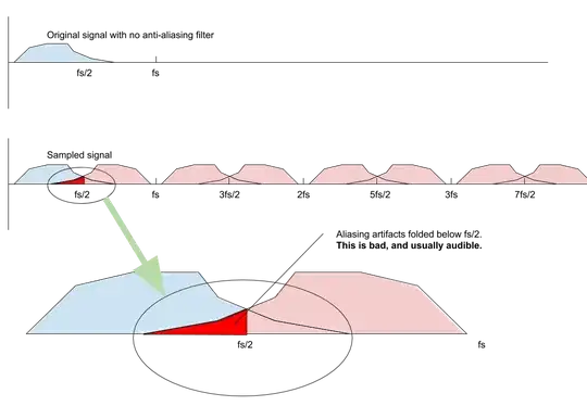

The easiest way to understand aliasing in the context of digital audio is to imagine the frequency ‘spectrum’ of the input audio signal laid out on an infinitely long strip of paper where the left hand side of the strip represents 0Hz (DC) and the frequency value increases as you extend the strip to the right.
enter image description hereAlternate folds in the strip are made at multiples of half of the sampling clock frequency (fs/2).
enter image description hereWhen you turn the folded strip to face the front you are looking at the portion of the strip that represents 0fs through fs/2.
The strip is transparent and you can see through all the folds of the strip right to the bottom.
Any frequency components that have values that extend past the first fold at fs/2 can be seen ‘mirrored’ onto the first ‘page’(baseband) of the spectrum between 0fs and fs/2. Any aliasing components falling between 0fs and ~18kHz are audible. \ \ The first trick with digital audio sampling is to filter the incoming audio to attenuate any audio presented at the input with a frequency above fs/2. This eliminates the unwanted aliasing components that are ‘printed through’ during sampling. This is achieved with an “anti-aliasing” filter which is explained further in the next section.
Additionally, the result of sampling also ‘prints’ the ‘wanted’ audio (contained between 0fs and fs/2) across the entire spectral range. It’s much the same as taking a folded strip, cutting out a shape and then unfolding the strip again to make a Christmas decoration.
Once again, those aliasing components can be removed using a filter, which is the core of how digital reconstruction is achieved.

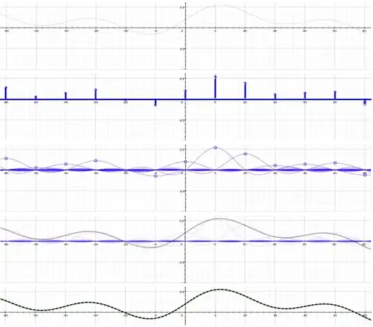

Wave Superposition
Wave superposition is the principle that two independent waves travelling over the same medium will pass through each other without either disturbing the other in any way. This applies to the sinc impulse responses generated by a DAC and forms the basis for which an analogue wave is reconstructed.
Each of the “sinc” impulses will pass through the same electrical medium however as they do so, they will coincide to form a new wave (whilst still obeying the law of wave superposition) and will re-generate the original intended analogue waveform.
