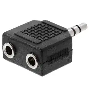

That's the standard configuration. You need a 'dual mono 3.5 mm jack to stereo 3.5 mm jack' adapter.
They're available as a short cable (as shown in the linked question), or as an adapter plug:
They're also available with a female stereo socket and male mono plugs, but that's not what you need. You also don't want a splitter, because that will have 2x stereo female jacks instead of mono.
