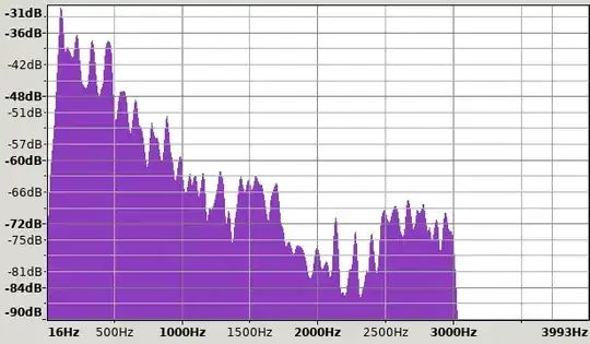

Basically I'm looking for the reverse of this question - I have voice recordings coming from a phone and I can immediately see from the spectrum that only frequencies up to 3khz have been preserved.
frequency spectrum recorded MP3
I'd like to, if there's a reasonable setup possible on Linux, to simulate the playback from the phone, so that the voice is more understandable (my problem is that I don't even really know what terms to search for, thus, this question) - what do I have to look for?

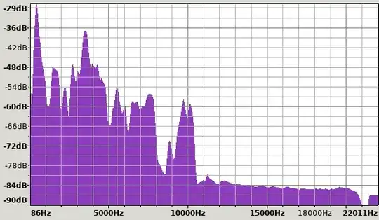

Edit: Okay, for some more thoughts, I've recorded the phone playback through a mic, which doesn't sound that dull, due to the awful speaker of course.
spectrum phone speaker recording
So, with a preference for the phone speaker emulation, how could I get the original recording more spread out / emulate the phone speaker? Assuming for example that I can record a profile of sorts of how the speaker plays any recorded input - not simply tweaking the equalizer settings of the existing recording.
