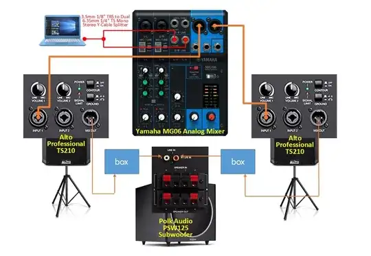

I have two Alto TS210 Powered Active Speakers connected to Yamaha MG06 Mixer, which is then connected to my laptop via Stereo Y-Cable. That setup is working fine, however, I would like to now add a sub-woofer.
Can I use the Polk Audio PSW125 Sub-woofer in my setup? How do I go about doing that? This sub is powered and does not require an AMP, it also has built-in crossover.

There are two problems we need to overcome:
  1. The mixer has no further outputs to connect the subwoofer.
  2. The subwoofer has unbalanced inputs, which seems to be at "Consumer Line-Level
So now we need to do the following:
  • Take the mix-output from both Alto TS210's, to feed the subwoofer.
  • "convert those from "balanced / professional line level" to "unbalanced / consumer line level"
As a picture is a thousands words, something like this:
As you can see, I have drawn two "box's" in the picture, which will have to do the conversion.
This can be done with some equipment, and here is an example:
enter image description here source:https://www.thomann.de/ie/sonifex_redbox_rbbl2.htm
Using this example you can use input-1 and output-1 to do exactly what you need.
However the cost of this type of equipment may be more expensive than actually buying a subwoofer with proffessional line level inputs/outputs, which actually does that without additional equipment.

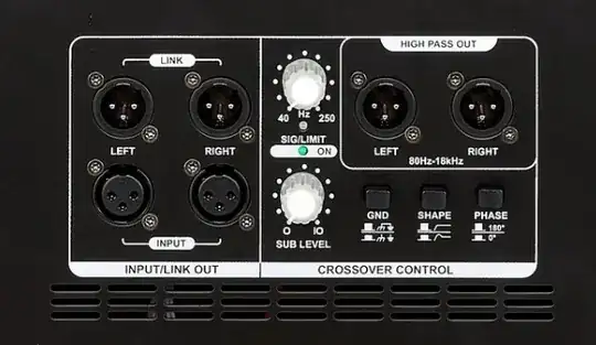

There are plenty of examples of alternative subwoofers which will do this, let me provide one here:
https://www.thomann.de/ie/fun_generation_pl_15_sub_a.htm
You would use "input" on the subwoofer to feed from the outputs of the mixing desk, then use "high pass out" on the subwoofer to connect your Alto's.
