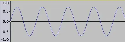

We start with this mono file: test.wav
In audacity it looks like this:
mono
Then we convert it to stereo with this command:
ffmpeg -i test.wav -ac 2 out.wav
Now it looks like this:
stereo
Notice that the amplitude changed!
Finally, we convert the stereo back to mono:
ffmpeg -i out.wav -ac 1 back.wav
We should get the same file from which we started. But in audacity we get the following picture:
sine wave with different phase and amplitude from original
The questions are:
1) Why did the amplitude change when converting to stereo?
2) Why did the amplitude not change back when converting to mono?
3) how can I make the amplitude change back when converting to mono?

1 - It seems that FFmpeg attempts to respect a common pan law (when routing a centered mono track to a stereo track, lower the mono signal by - 3 dB on each channel of the stereo track). The goal is that the perceived loudness remains coherent.
EDIT
As mentioned by @Mulvya, you can use the pan filter to keep input file level untouched :
ffmpeg -i test.wav -af "pan=stereo|c0=c0|c1=c0" out.wav
END EDIT
2 - It seems that FFmpeg attempts to lower each of the contributing mono signals to prevent the sum to be over maximum level in the destination track.
I couldn't find a definitive description of the processes involved when using the -ac option, but on the AudioChannelManipulation page, you can find the following sentence :
ffmpeg integrates a default down-mix (and up-mix) system that should be preferred (the -ac option) over the pan filter unless you have very specific needs.
3 - For a 2 channel input to a 1 channel output, it seems that :
ffmpeg -i out.wav -filter:a "volume=3dB" -ac 1 back.wav
restores the original level. That should be used with care in the general case for the reasons mentionned above (prevent overloading).
