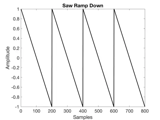

This comes down to the question of audibiltiy of phase in a signal. To test this, I created two signals (both with f0 = 220.5 Hz, Fs = 44100 Hz) in Matlab, a saw wave with an upwards facing ramp and one with a downwards facing ramp:
ramp_up = repmat(linspace(-1, 1, 200), 1, 440)';
ramp_dn = repmat(linspace(1, -1, 200), 1, 440)';
These are (excerpts of) the resulting signals:
You can listen to them here (careful, relatively loud):

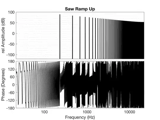

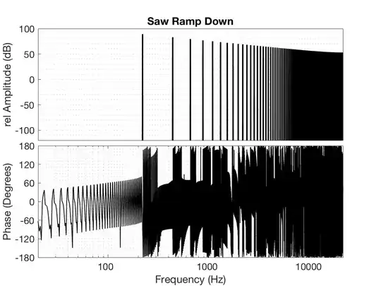

There is no audible difference between the two. Let's now look at the magnitude and phase spectra of the signals:
We can see that the magnitude spectrum (top part of graphs) for both signals is identical, yet there are differences in the phase spectrum (bottom part of graphs). For these signals, the difference in phase seems to be inaudible. Note however that current science on this topic suggests that under lab conditions phase distortions can be audible. Further reading on the topic:

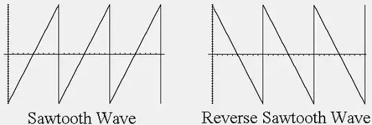

They will sound exactly the same. The human ear responds to the frequency of the waveform - not the direction of the waveform itself.

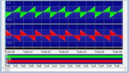

I tested saw wave with different frequency with headphone, and the result is you can distinguish in frequency around 60Hz, it gave different pressure feeling pattern in your head when inverse the wave.
Also, it took time to the brain remember the feeling to compare with new sound input. You'll need to focus to listen for a minute (and feel the vibration inside head too), then switch to other. And then play this sound few second and switch sound and play... it change a little and you can distinguish it.
However, when change higher >60Hz or lower <60Hz, it gave the same feeling. And if you play the 60Hz on speaker, you won't able to distinguish it.
Tested on GoldWave: f(x) = (2ft%2-1)/2
f=60

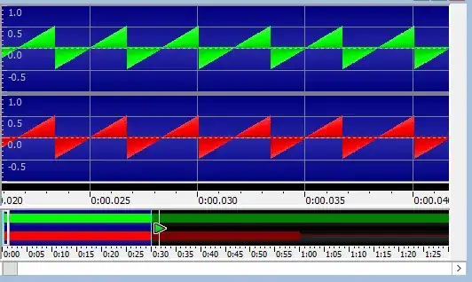

When combining to stereo, one file have Left Right same, another file have Left Right mirror symmetric, you can distinguish it easily in any range frequency (must use headphone)
Same:
Mirror:
