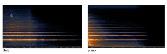

A way to understand timbre and differences between instruments is to interpret harmonics by casting an eye on their spectrograms: flute and piano spectrogram The flute has some tremolo visible on the high-end sustained harmonics that look consistent throughout the sample.
Piano, on the other hand, has gradient like harmonics fading towards the higher ones. Also the wavefile has a shorter release time than the flute one.
