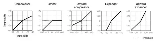

Dynamic Functions In General
Here is a simple guide on the various dynamic functions. The gate is not listed - a gate is like downward expander (or simply "expander"), only the output is completely cut off below threshold (the lower vertical line is completely vertical).
The input signal is represented on the x-axis, and the output signal is on the y-axis. A completely untouched signal would be straight linear from lower left corner towards upper right corner (same in..same out):
dynamic functions
Image source: https://musicjourneys.wordpress.com/2013/04/01/dynamic-processors/
