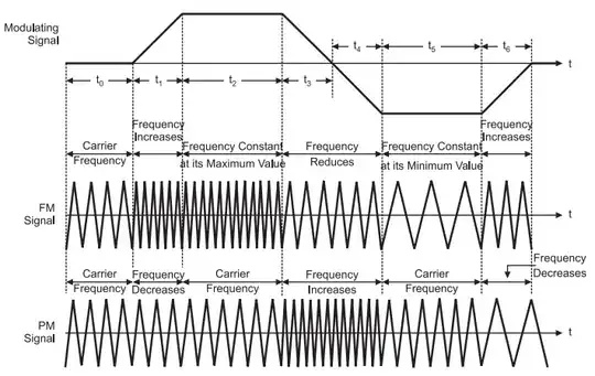

Late to the party, but here is a graph showing the difference.
They do sound quite different, i.e.: DX7 (pm) & Synergy (FM)
