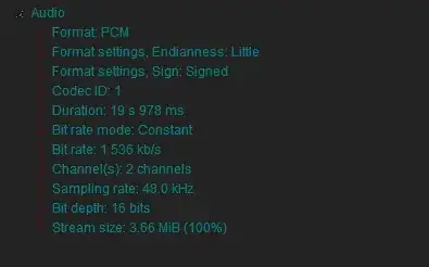

There are many audio formats, but generally, the file headers and format chunk can quite easily give you some specific format information if that's all you need; things like the amount of channels, samples per second, bits per sample, etc. Frequency and other data information is locked up in the data, which would need to be interpreted.
A MediaInfo report of a .wav file, most of which is reported by the header and format chunks: enter image description here
