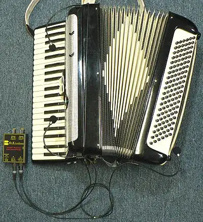

I would go with 2-4 goosenecked clip microphones positioned in top and bottom of each sound source, something like this:
The important thing here is that the mics stay at a fixed position, so you will not get varying levels as you play and move around, as with a mic on a stand.

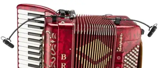

The DPA 4099 series would be a good choice. They actually made an accordion optimized package: d:vote™ VO4099A Stereo Microphone System for Accordion
If you want a cheaper option, which sound good too (but constructionwise is not as good as the DPA), take a look at Thomanns t.bone Ovid System CC 100 The ovid mic also comes in a bundle with lots of different mounting options:
