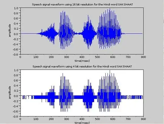

EDIT: I've found this very interesting article about speech processing in different sample rates and bit depths, which is precissely the field I'm investigating also: http://iitg.vlab.co.in/?sub=59&brch=164&sim=474&cnt=1
Source: (2011). Sampling Frequency and Bit Resolution for Speech Signal Processing. Retrieved 11 June 2016 from http://iitg.vlab.co.in/?sub=59&brch=164&sim=474&cnt=1
However, I cannot seem to find which programs or techniques are used to record at low bit-depth, or if they record at 16-bit and then lower the bit depth of the already recorded signal (I believe this is called "bit crushing" technique?).
