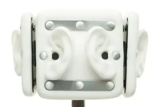

That's what they call "omni-binaural", captured with microphones like this one.
It provides 4 stereo independent binaural channels, one channel for each direction+orientation. On VR video playback, a linear mix of the different channels is made, depending on the actual momentary orientation of the user.

  • Interesting. Any idea how to encode a mix for omni-binaural? Also, to be clear I still don't see how this differs from the delivery of a quadraphonic mix as Samsung has it listed. Both formats allow for 4 mono or stereo tracks and both use the same definition for each track (Track 1 = 0 degrees, 2 = 90 degrees, 3 = 180 degrees, 4 = 270 degrees). Is the binaural format taking into account HRTFs? – Reed May 12 '16 at 17:43
  • I'm not familiar with the production process for VR systems proper, sorry. But I would expect the omni-binaural would not require specific enconding (I mean channel enconding, not audio enconding), as each captured channel is going to be directly fed to the respective input channel. But it would have to be sound captured with an omni-binaural mic. Quadraphonic input would be to feed a "mix" generated by means other than omni-binaural (studio produced movie soundtrack, musical audio, etc.) Clarification, not both formats allow either mono or stereo, there's no such thing as mono binaural. – José David May 12 '16 at 17:57
