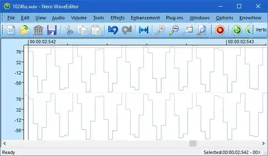

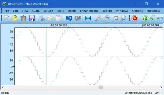

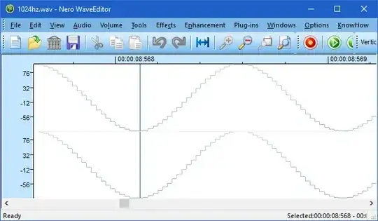

How Artifacts happen
This is a 1024hz wave at a sample rate of 44.1khz
2048hz at a sample rate of 44.1khz
4096hz
8192hz
16192hz
Now this does not even come close to a sinewave anymore. You see the highest note you can playback with a sample rate of 44.1khz is a 22050hz triangle wave.
Yes, it looks like a Square wave in nero Wave Editor but really it's a triangle wave. Actually it's not possible at all to re-create a pure square wave because they require an infinite samplerate (You would need 2 datapoints, one at the top and one at the bottom, at the same timeframe. That is not possible)
The important thing we need to understand is that when speeding up sound by a factor of 2 the software will pick Data Point 1 & Data Point 2 and average them creating the new Data Point 1. Then it will pick Data Point 3 & Data Point 4 and average them creating the new Data Point 2, and so on. Nero Wave Editor has a different approach: he starts with Data Point 1 and simply ignores every other Data Point. Transposing a 22050hz wave by 1 octave looks like this. Dead Silence with an offset:

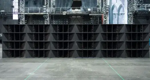

The correlation between frequency and membrane diameter
Because loudspeakers are my field of knowledge more so than microphones I will provide examples with loudspeakers but the principles are the same. A Subwoofer with a membrane diameter of 46cm and a moving mass of 200g will not be able to reproduce a 20khz note with a lot of volume. It has nothing to do with the weight of the membrane and everything to do with stiffness. If you send a 20khz note throuh a large Subwoofer the membrane will not oscillate uniformly. It will look a lot worse than this:
Now if you take a very small loudspeaker with a membrane diameter of 8cm and pass a 1hz sine wave through it the pressure will not be transmitted to the air around the speaker that is responsible for carrying sound to your ear. This is called a mismatch in acoustic Impedance. The air does not absorb and transmit the pressure wave but instead it moves out of the way of the speaker. Let's not get into the math of this but it's very much like trying to paddle a boat with a small stick. The water will simply flow around the stick.
In order to properly transmit a 1hz sine wave you would need an immense membrane, hundreds of metres in diameter. Horn speakers are a cheap fix. Technology does not allow us to create membranes of sufficient size therefore we connect horns to small membranes. Large membranes would prove horn systems useless. A small membrane 30cm in diameter is too small to properly transmit bass frequencies into the air. A long-throw horn system will couple the membrane to the air more efficiently and match the acoustic impedance.
Or you start stacking these, also called an URPS:
