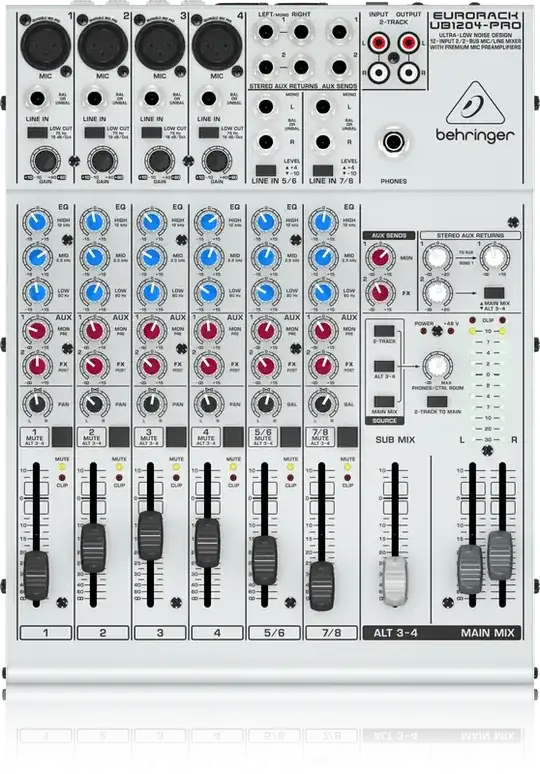

You could use a mixer with two AUX sends, like this EURORACK UB1204-PRO:
This will allow you to route a signal back to the computers. One would be AUX 1 and the other AUX 2. From any channel on the mixer you can control how much is going back to the AUX'es. You should use the Line In on the computer when connecting this way.
You may need to find an adapter for the headset microphone to work in the mixer, or get an XLR based microphone (which most likely will sound much better anyway).
Important: Check out this question about using headsets with mixers.

Michael is correct that a mixer will handle the "magic" but you will have to check on the combination input/output ports on the computers. Some are designed to handle headphones with a mic (TRRS) and others are either input or output (TRS) with internal switching, but NOT both at the same time. You'll have to verify which type you have from the manufacturer.
If they are single use only you'll need something like this to allow input from the mixer and use the on-board jack for output.
