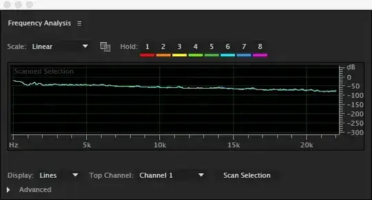

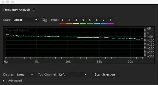

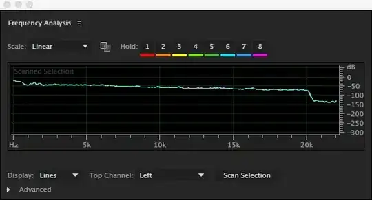

After analysing various converted mp3's I've found out that the LAME encoder uses a lowpass filter for the insane preset (CBR 320), but the filter seems to be disabled for the extreme preset (VBR V0). That doesn't make sense right? I'm wondering why that is the case and what would be the best practice regarding the filter if filesize doesn't really matter.
Original Flac file:
original
Extreme preset:

extreme
Insane preset:
$ lame  original.wav --preset insane insane.mp3
    LAME 3.99.5 64bits (http://lame.sf.net)
    Using polyphase lowpass filter, transition band: 20094 Hz - 20627 Hz

insane

insane --lowpass -1
