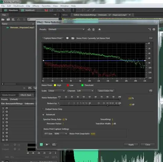

Adobe Audition has a built in Noise Reduction effect that works really well. Effects>Noise Reduction/Restoration. You can use this to capture the noise profile of the background music or other sounds you want to remove. Just find the longest section where only the unwanted sound is playing in isolation, and grab this. The longer the selection, the more precisely the Reduction can work. Then, select a section of the audio you would like to test, and open the NR settings to adjust the amount.
For full control, you will need to use the "Advanced" drop down, where you can choose a larger FFT size for greater Noise print fidelity. I suggest playing around with the other settings to find the best balance, because extreme settings will drop unwanted artifacts. I can elaborate on the basics of most of these settings, but I generally have had to just play around until I get the ideal result.
The good news in the case of vocal material is that you can generally get away with a lot of NR before losing quality.
Audition Noise Cancellation
