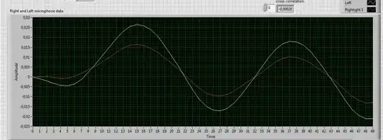

I am using two similar microphones for my Active Noise Cancellation project. I need to use the microphone input values in LMS Algorithm,I want to standardize the two microphones, so the iterative adaptation will be precise. The problem is I am getting two different signals for two microphones under similar noise or under with out any noise.

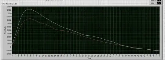

I tried to model the difference in two signals, but it is getting really complicated as it is changing with noise source amplitude and distance from noise source and also there is a DC Offset factor ( or some picked up signal !!?) involved which is making two signals shift from zero position.
How can two microphones values differ of same quality?
With sinusoidal standard noise (Amplitude 2, frequency 2kHz, Sampling rate 44.1kHz, number of samples 50) enter image description here 1st picture: With sinusoidal standard noise (Amplitude 2, frequency 2kHz, Sampling rate 44.1kHz, number of samples 50)
2nd picture: With out any sound !!

Edit: I have now used a band pass filter, now the wave forms are much smoother. The two new images are response of microphones taken when they are placed right infront of speaker. I could be able to match the phase of two after some work! Now m1=1.656*m2; The 2nd picture (with out any noise) is giving m1=1.317m2; Obviously these values are too random( varying between 1.3-1.6) over the distance. I am trying to find some approximate or appropriate correction factor.

  • The first picture shows a phase problem. Also if you are using white noise, if I'm right i guess that the signal won't be the same at one moment or another. Are your mics new or are they second-hand sales? – JSmith Nov 07 '15 at 17:07
  • @jonhatansmith mics are new but are of cheap quality not omni-directional. mics. I am not using any gaussian noise, simple pure sine wave sound ( amplitude 2, frequency 2kHz, Sampling rate 44.1kHz, number of samples 50) . I recorded this sound using MATLAB and I am using LabVIEW for analysis (NI myRIO 1900 module). – charansai Nov 07 '15 at 19:39
    Thx for the specs. I might not help you fully with your prblm but cheap mics might not be the best way to have accurate results. I think someone already told you that but you cold delay your mics to reduce phase difference this post might help you. Cheers – JSmith Nov 07 '15 at 20:32
  • Note that your interface, recording software, and settings are likely to be factors here, so you can't assume that the samples that you have on disk reflect only the effects of the two microphones. Even if both mics were magically identical and more magically located in the exact same place pointing the exact same direction., it would be very unlikely to get the same recording from them. – Todd Wilcox Nov 09 '15 at 14:04
  • jonhatansmith Thank you. @ToddWilcox Yeah,I agree.I found the problem is more basic.Even if I place the two microphones touching each other, their centers are around 1cm apart.So, eventually the signal received by the both will differ in magnitude and phase.Now I have used band pass filter and response is much better and also I am getting correction factor between 1.2 and 1.5, again changing with distance and position. There are bunch of other things that I need to consider like frequency response and directionality of microphones and ADC accuracy so on.. Hopefully I will figure it out soon – charansai Nov 09 '15 at 14:51
  • What exactly do you mean by "standardize"? I can probably help you but I think our vernacular may be slightly different. Also, any equipment specs and possibly images depicting your microphone configuration could be useful. – voices Nov 10 '15 at 05:29
  • @tjt263 I meant like, I want to find the relative change in amplitude (or even frequency) response of two microphones if they are placed at exact same position in front of the noise source. I am using the cheap quality mics( the link I gave in 2nd comment). Their specs are 'frequency range'-100-10k Hz,Sensitivity -54 ± 3 dB (A) decibels, Polar Pattern Supercardioid. I did not understand what do you mean by microphone configuration and equipment specs. Do you mean NI myRIO 1900 'ADC' and ''Audio In & Out'' details !? – charansai Nov 10 '15 at 13:56
