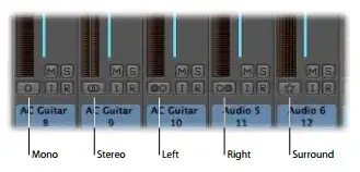

Take a look at the bottom of the Channel Strip section. Here you will find a Format button that shows if the track is stereo or mono (there is a two-circle icon indicating it is stereo):
or
Click-hold the button and select either Left or Right channel:
Additional details in the manual around page 264-265.
Note that if you want to physically change the file format, you need to bounce a split stereo PCM, reimport one of the channels, delete the other (and the original stereo file and track).

  • Thank you so much. In logic pro x there is another button: http://imgur.com/GYuTVjT This "Button" is a split button. Which means that the stereo symbol on the left side pops out another menu then the right area of that button. Your answer and screenshots helped me seeing this. Thank you so much! – JackPearse Nov 05 '15 at 12:47
    @JackPearse Cool - I added your image to the answer. – Michael Hansen Buur Nov 05 '15 at 13:26
