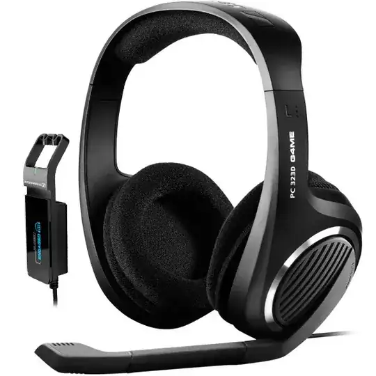

The on-board mic/line-ins in laptops are at best crappy ;-) "USB Headphones" are likely to remove the typical line noise as the A/D D/A conversion is taking place in the connector itself, only sharing the PSU with the motherboard.
About wireless headphones: if you can find a model that specifically states it uses companding techniques to improve the signal, it may be doable. Otherwise (and in particular if your budget is low) I'd steer clear of those as you likely will be experiencing other issues due to the wireless transmission (such as drop outs, interference with mobiles, WAN etc.).
However as you note these converters may as be of varying quality. Go for medium series in a well-known brand. I'm sure some of the "mid range" Sennheiser headsets will work just fine for you. For example PC 323D, which comes with a special USB adapter that takes care of removing hizz, etc (scroll down to the 3D GAME1 section):
If you want to step up, take a look at the HMD 280 PRO and consider investing in a proper external audio interface.
If you want a cheaper option, take a look at PC 36 or PC 8, which will not suffer from the on board noise as well, but the quality is inferior to the PC 323D.

  • @JonCoombs then go for a Sennheiser headset within your budget. The reason why I mention that exact Sennheiser model is that it will take care of eliminating the noise from the on board interface. You don't need additional adapters. I updated the post with additional answers (really you should try not to group that many questions into one "question"). – Michael Hansen Buur Oct 30 '15 at 07:08
