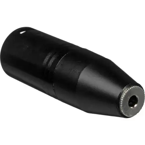

If you are able to wire an adapter yourself, you can do it this way (it will not be a balanced connection though).
  1. Shield to XLR male Pin 1 (Ground)
  2. White wire goes to XLR male Pin 2 (Signal)
  3. Bridge XLR male Pin 3 to XLR Pin 1 (Ground)
Important! Do not send phantom power to the microphone (it will damage it!)! Use the inline power pack with battery to power the microphone.
You should also be able to use an adapter like the Rode VXLR: enter image description here
Just remember: NO PHANTOM POWER ;-) Use the battery option..
