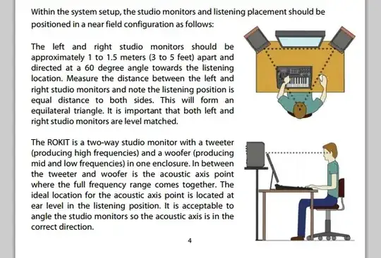

I recently purchased my first pair of studio monitors, KRK Rokit 6's. The instruction manual states...
...and accordingly I've placed the monitors 5' apart and 5' from me, with the acoustic axis level with my ears.
Sounds great, but when I roll my chair 3.5' back, I pass this threshold region no wider than 0.5', where I suddenly get slammed by a massive layer of bass and oomph. That sounds like what I want to hear! But have my ears just been trained to have too much affinity for bass? Yet, it feels like there's no bass at all when I return to where I'm supposed to sit. Is this common and expected with studio setups?
